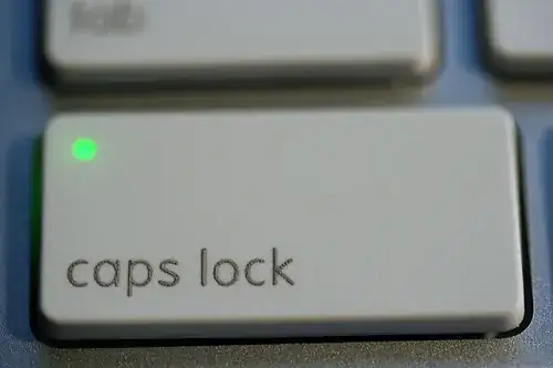

I don't use the CAPS LOCK functionality in OS X, so I disabled the key under the system preferences. Now that key is completely useless to me - ok, I could map the CMD/CTRL/ALT key to that key, but I already got keys for that…
So what I have in mind is to use the LED on the key (I use the recent Apple wireless keyboard) to annouce if I've got mails waiting… something like that. Is it possible to control the LED directly? Controlling it via an objective-c cocoa app is okay, I'll write that app by myself, but until now, I can find anything useful from Apples cocoa documentation.

    { "numlock",  optional_argument, 0, 'n' },
    { 0, 0, 0, 0 },
int
main (int argc, char **argv)
    UInt32 whichLED = (UInt32)0;
    int c, ctr = 0;
    int target_value = -1;
    while ((c = getopt_long(argc, argv, options, long_options, NULL)) != -1) {
        switch (c) {
        case 0:
            break;
        case 'c':
            ctr++;
            whichLED = kHIDUsage_LED_CapsLock;
            if (optarg) {
                capslock_value = atoi(optarg);
                target_value = (capslock_value);
            break;
        case 'h':
            usage();
            exit(0);
            break;
        case 'n':
            ctr++;
            whichLED = kHIDUsage_LED_NumLock;
            if (optarg) {
                numlock_value = atoi(optarg);
                target_value = (numlock_value);
            break;
        default:
            usage();
            exit(1);
            break;
    if (ctr != 1) {
        fprintf(stderr, "Missing options or invalid combination of options. "
                        "Try -h for help.\n");
        exit(1);
    return manipulate_led(whichLED, target_value);
To compile and use this script
gcc -Wall -o keyboard_leds keyboard_leds.c \
    -framework IOKit -framework CoreFoundation
./keyboard_leds -h
./keyboard_leds -c # query caps lock LED state
./keyboard_leds -c1 # turn caps lock LED on
./keyboard_leds -c0 # turn caps lock LED off
