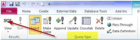

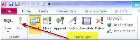

You can run a query in Access by doing the following:
  1. Go to the "Create" tab and click "Query Design"
  2. Just close the window that appears which asks you to select tables, we don't need that.
  3. Go to the "Design" tab and click the button with the arrow until you get a textual input screen. (By default, it says SELECT;).
  4. Delete the default text and paste the above query.
  5. Click "Run".
