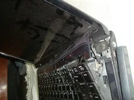

A defective or under powered AC adapter can cause system overheating. I had a HP notebook and had no AC adapter, so I used an AC adapter with a lower amp rating than the original, the notebook ran hot and the fan ran constantly, I eventually found the correct amperage rated AC adapter and things returned to normal.
Never experienced a bad battery causing overheating of the system, I have seen the defective battery itself overheat, and can explode under certain circumstances.

  • That's what I call a reasonable good answer to keep for further referencing to others. Informative, no tech details and has nice photos. – kagali-san May 26 '11 at 23:13
