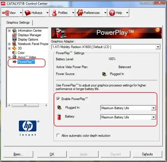

Turns out that with the ATI Video drivers for that laptop, for Vista, the GPU was always turned up high. Even if the CPU was doing nothing. And this generated lots of heat.
I guess this is to take advantage of the fancy graphics in Vista, but I wasn't using the graphics. I just wanted a cool, quiet laptop.
I went into the ATI "Catalyst Control Center":
CCC
...and turned on the PowerPlay feature. This is a way you can turn down the GPU administratively.
By setting it to "max battery life" even when plugged in, the computer was no longer hot. The CPU temp is now 50C, and the fan is quieter.
It's now no longer melting the stickpoint things, too.

    Ah, the joys of having Intel chipset graphics. Not much graphics performance but not much heat either :) (and suffices easily for Aero :)) – Joey Aug 24 '09 at 21:43
  • yeap, I am running Aero too, and even at the lowest GPU Setting, it's really just fine. I haven't noticed any slowdown after turning everything down. Except for the fan. – Cheeso Aug 24 '09 at 21:48
