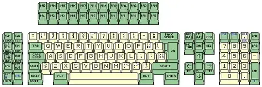

A colleague has just come into possession of a large number of IBM PC 3270 keyboards (don't ask!). These keyboards have a number of very interesting looking keys, but the one that most intrigued us is the one at the bottom right of the block illustrated here:
Keyboard picture
In the absence of knowing its purpose, we've nicknamed it the "person in a wheelchair being chased down a hill by a boulder" key. We are relatively confident, however, that this isn't its actual name.
Any PC/mainframe history buffs able to help us out?

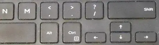

    On IBM's current keyboards, they have replaced that with this more descriptive key: https://i.stack.imgur.com/mUtpD.jpg – fixer1234 Nov 01 '16 at 18:32

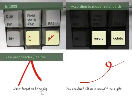

I do know the symbol on the bottom right key as being the symbol typically used when proofreading written documents. It is a delete. When you write that over a letter or word in a paper, it indicates that it is unneeded and should be removed. Seeing as how this is an older keyboard, the users of the equipment at the time likely would be very familiar with proofreading symbols and understand what it represents.
My guess (without having used the machine in question) is that it likely is the delete key.
This page goes through a history of some IBM keyboard layouts, and a few pages down you see this image:
IBM 3270 keyboard layout
You can see the key layout in your screenshot above the arrow keys. The key layout is:
Dup/PA1    FM/PA2    PA3
Back Tab   Insert    Delete
The delete mark on the key makes sense, especially combined with the proof-reading mark also used for "insert".

    It makes sense. I remember an old guy I knew doing proofreading of a document. To show that a character should be deleted, draw a line starting at the character, going to the upper right, and put a little loop on the end. It looks sort of like that picture! – GEdgar May 31 '11 at 13:58
    Also makes sense wrt the key to its left: the "a with a hat" is like the proofreading symbol for "insert this text here" – Adam Bellaire May 31 '11 at 14:24

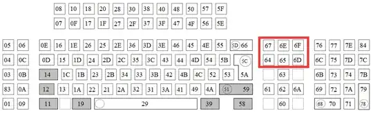

This is an IBM 6110344 keyboard and the keys on the 6110344 are laid out like this:
So the key you're looking for corresponds to scan code "6D". When we look at the related scan codes on the link given above, that key turns out to be Del, namely Delete.

It does look like a proofreading notation. A letter with a bar crossing it out and a circle. Refer to delete in this page: enter image description herehttps://people.sunyit.edu/~russ/Com310/ProofreadSymbols.pdf

Check out the first item in this list: http://wadsworth.com/english_d/templates/student_resources/1413001890_burnett/UsageHandbook/edit_marks.htm
It's supposed to be the old fashioned delete symbol. You may remember this symbol from elementary school, but I guess most people have probably never seen it. Myself, I haven't hand-written a school paper since at least 5th grade (1997ish), so it's been quite a while.

The sound of typing on this thing is oddly satisfying to me.
About the mystery key(s):
Proofreading marks used on keyboard keys for inserting- and deleting characters
https://grammarist.com/editing/proofreading-editing-marks-symbols/
