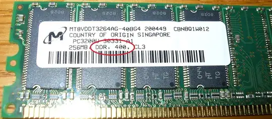

  • @David is right, there should be no reason for it not to work, at worst you'll need to check the memory types are the same (DDR, DDR2 or DDR3). Metal Gear Solid has a good image of how to identify the types [here](http://superuser.com/questions/80092/can-you-tell-ddr-and-ddr2-apart-visually/141394#141394) – Mokubai Jun 01 '11 at 19:35

  • Thanks @Mokubai but too late... :( I found a nice high res picture on google though! :D – David Jun 01 '11 at 19:40
    Yeah, ;) though without a sticker like that (as @SimonSheehan seems to suggest is missing in his question) identification could be, well, *interesting*... – Mokubai Jun 01 '11 at 19:44
