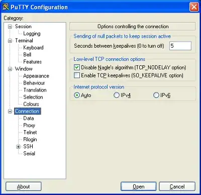

  1. Start Putty
  2. Load your connection settings if you have them saved
  3. Click on “Connection”
  4. On the section that says "Sending of null packets to keep session active", Changed it to 5 seconds. 300 seconds may be better if network outages are your problem, read below for details.
How keepalives to prevent disconnection with Putty:
Some network routers and firewalls need to keep track of all connections through them. Usually, these firewalls will assume a connection is dead if no data is transferred in either direction after a certain time interval. This can cause PuTTY sessions to be unexpectedly closed by the firewall if no traffic is seen in the session for some time.
The keepalive option (‘Seconds between keepalives’) allows you to configure PuTTY to send data through the session at regular intervals, in a way that does not disrupt the actual terminal session. If you find your firewall is cutting idle connections off, you can try entering a non-zero value in this field. The value is measured in seconds; so, for example, if your firewall cuts connections off after ten minutes then you might want to enter 300 seconds (5 minutes) in the box.
