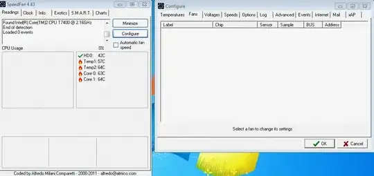

11
It will depend on your computer, BUS type, and possibly the type of fan it has (some 2-wire fans, common in laptops, do not show up).
I would definitely download Speedfan here:
http://www.almico.com/speedfan.php
Then go to Readings tab>Configure>Fans tab. If your fan shows up, you can configure it, if not, I doubt there will be a way to configure it.
As you can see in the screenshot, I cannot configure my laptop's fans, so this is not uncommon.
This is probably because I have an unsupported BUS, as can be seen on this page:
http://www.almico.com/forumbuses.php
I looked for both of your BUS'es, but could not find details on them. You can find this using Software Information for Windows, run it, and look in the motherboard section, or you can simply install Speedfan, and see if the fans show up.
