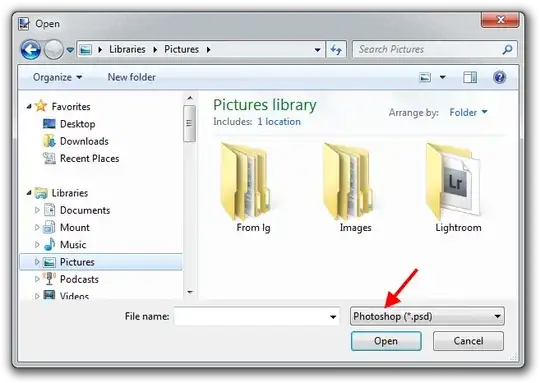

In order to preserve the opacity/transparency of the layer while using the bucket fill tool, you can click the "Lock Transparency" button in the layers dialog (see image below).
example image
Then, you can either create a selection of the objects or simply fill the entire image with the bucket tool. The alpha of the layer will remain unmodified.
