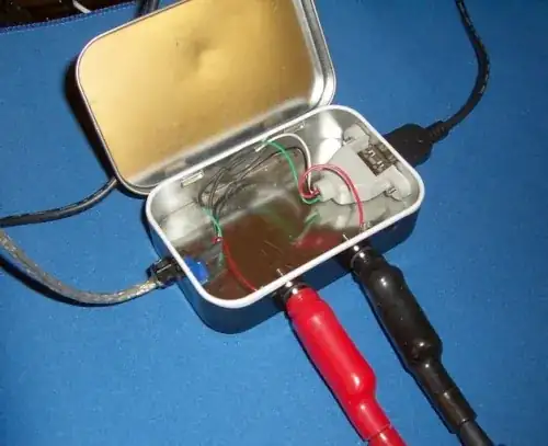

One (very cool!) way I found:
https://web.archive.org/web/20130529073635/http://www.ultramobilegeek.com/2007/02/measuring-power-on-peripherals-usb.html
When I write peripheral reviews for ultra-mobile devices, people constantly ask me how significant the power draw is for the device. Previously, I had no answer. Today, I whipped up a rough way to find a solution.
I call it my USB Drawbox. Attached to a multimeter, it measures the number of milliamperes (mA) any given device pulls over USB. Generally, devices will request up to 500 mA. Above that, standard ports will shut down power to the device. Some devices, notably external hard drives and CD-ROM drives, can pull power from two USB ports simultaneously using a Y connector.
usb drawbox
This little DIY hack requires a tiny bit of solder, a tiny bit of Dremel skills, and a whole lot of testing and tweaking. The way I did it - in a metal Penguin Mints tin - required some VERY careful insulation on the screws that went through the banana jacks. Other than that, it was pretty straightforward.
Jeff Atwood
  • 23,972
  • 99
  • 120
  • Cool, I think I might build one of those – MBraedley Jun 16 '11 at 11:12
  • Someone should start selling those. – Peltier Jun 16 '11 at 11:29
    "_required some VERY careful insulation_" Isn't that why plastic boxes were invented \*g\* – oleschri Jun 16 '11 at 15:00
    This tests what the device draws, rather than what the port can deliver at maximum, cool diy though. – Moab Jun 16 '11 at 15:27
    @oleschri The metal box acts as a Faraday cage and prevents interference, the original shielded cable that prevents interference is opened here to interpose the multi-meter so the metal box is a must. – Eduard Florinescu Aug 27 '15 at 07:29
  • This box will work only for FS and LS devices, like mouse/keyboard, low-quality audio etc. This won't work for 480 Mbps HS devices because the green-white twisted pair impedance is brutally distorted, so the measurements will be for non-functional unconfigured devices, that's it. It is possible to do a better job and not to touch the differential pair, and cut only the red wire though. – Ale..chenski Dec 21 '19 at 01:08
