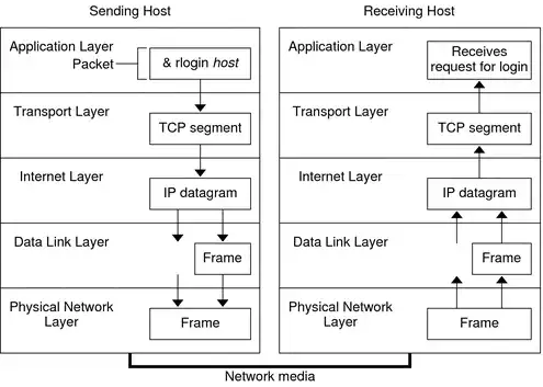

We say TCP segment is the protocol data unit which consists a TCP header and an application data piece (packet) which comes from the (upper) Application Layer. Transport layer data is generally named as segment and network layer data unit is named as datagram but when we use UDP as transport layer protocol we don't say UDP segment, instead, we say UDP datagram. I think this is because we do not segmentate UDP data unit (segmentation is made in transport layer when we use TCP).
Data Encapsulation and the TCP/IP Protocol Stack
