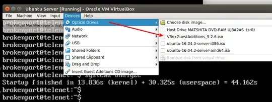

Un-checking the Guest Additions iso from Devices may help you - it did for me:
I say Reinstate Monica
  • 25,487
  • 95
  • 131
