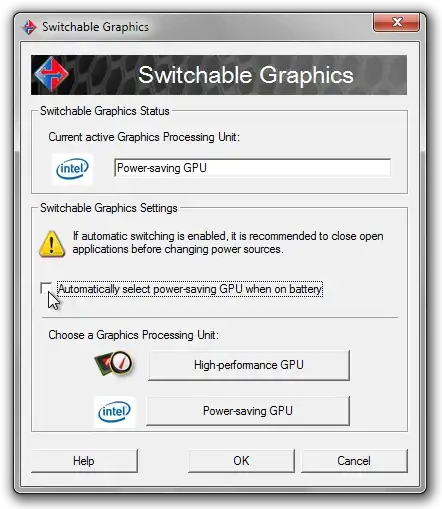

Right-click on the Desktop and choose the option for "Configure switchable graphics". In the dialog that appears, you will see an option for "Automatically select power-saving GPU when on battery". This option controls whether the graphics switch automatically. If you uncheck the box, then the GPU should only switch when you manually change it using the specific buttons.
AMD switchable graphics
(Note, this is the procedure on my HP laptop with ATI switchable graphics. I assume it is the same or similar for your Acer, as the drivers should be the same, but I can't guarantee that it'll work.)

  • That's my main problem. I've the same window with the settings in the middle but without the content (the yellow thing) and the rest. – Saifallah Aug 03 '11 at 08:31
    Well now that's odd. Have you updated the graphics drivers to the latest version? – nhinkle Aug 03 '11 at 15:11
  • Yeah just did yesterday. But now it's a little bit different (on the eye) and the option is still missing. – Saifallah Aug 04 '11 at 08:57
  • No more a Windows user. I'll mark this answer as correct. – Saifallah Oct 15 '12 at 13:56
  • Saifallah, Please see my answer here: http://superuser.com/questions/64322/how-to-turn-off-ati-adapter-on-acer-timeline-4810g-with-ubuntu-9-10 – marcolopes Jun 12 '14 at 16:07
  • If you don't have that option, it means you need to update your ATI driver to get that option, for example using leshcatlabs's UniFL drivers (select one with "Fixed Mode" driver): http://leshcatlabs.net/downloads_unfil/ – gaborous May 14 '15 at 15:49
