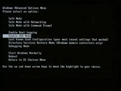

  • Try Enable VGA Mode – ThatGuyInIT Jun 24 '11 at 02:38
  • If Enable VGA Mode works, you can then try Uninstalling the Nvidia or if you can get to command prompt try running the following command:"C:\Windows\SysWOW64\RunDll32.EXE" "C:\Program Files\NVIDIA Corporation\Installer2\installer.1\NVI2.DLL",UninstallPackage Display.Driver – ThatGuyInIT Jun 24 '11 at 15:47

  • Safe Mode doesn't boot. How do I enable VGA only mode? – Razor Storm Jun 24 '11 at 17:27
  • It is in the same list of options to get into Safe Mode, it will be in the middle of the menu. – ThatGuyInIT Jun 27 '11 at 09:21
  • I don't have VGA only mode, instead there's only a "enable low resolution mode" which doesn't work – Razor Storm Jun 28 '11 at 02:16
