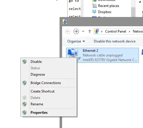

Apparently, assuming one of your systems supports autonegotiation the following process will work
  1. connect both the systems with an ethernet cable - a plain vanilla one will work with autonegotiation, else you'll need a crossover. Most modern systems support it.
  2. You'll need to set up both systems with static IP addresses, ideally from one of the 3 private blocks. Since most home networking uses the class C block, i chose to use the class A block, using the subnet mask 255.0.0 from here.
Currently i don't know what is the proper default gateway to use for the 'server', so as far as the systems are concerned, its a private network - so any sharing will need the ports explicitly opened in the firewall. I need to work out how to fix this.
In order to set up static IP addresses
go to Control Panel\Network and Internet\Network and Sharing Center
select change adaptor settings
select the Local Area Connection/ethernet connection (it seems to vary between windows 7 and 8)
select properties
Select Internet Protocol Version 4 and hit properties
I use these settings for the 'server'
for the 'client'
You can set the connection type as anything on the 'client' - it will be stuck as 'public' on the server.
