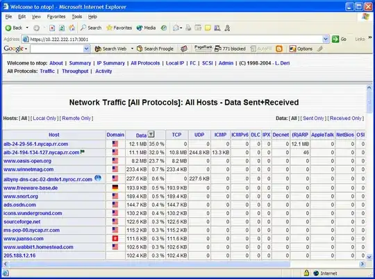

If you want to be the nasty person you could enable NetFlow on your DD-WRT and configure it to send it to another computer that's running ntop and is configured to receive from the router to track him down.
