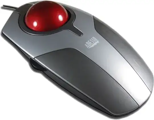

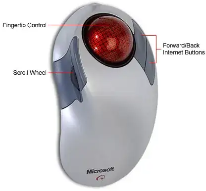

There are such marble mouse (mice) that have a scroll wheel included. Otherwise,it looks like an app or some script would be required for a non wheeled mouse along with the use of one of the buttons to engage a scroll function (that you noted in a comment to another answer, as not an acceptable solution).
So "Why reinvent the wheel?" is a good adage in this case.
In these examples, the element is physically installed and there are many types to choose from. Below are two examples and styles.
wh1
Or something like this:Adesso
wh2

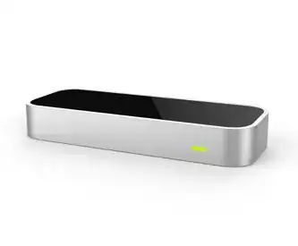

Two non conventional options
Image credit http://www5.pcmag.com/media/images/393268-leap-motion-controller.jpg
