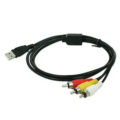

Does anyone know what these RCA-to-USB cables are/do? There doesn’t seem to be any electronics in the cable like an EasyCap, so I can only assume that the RCA connectors are directly connected to the USB pins. I suppose that it could be used for A/V capture, assuming of course that there were some kind of driver/software, but then again, I doubt that the computer would pick it up as a device of any kind when you connect it since it would be directly connected to a TV/VCR/etc. Looking around, I see mentions of connecting it to “RCA cameras”, but that does not clear things up at all.
What are they?

    I am also incredibly interested in this. Those cables are being sold all over the place, and as far as I can tell, they are completely useless. RCA type plugs are typically used for composite video and audio, both analog signals, and USB is a digital signal. Without a converting the signal this cable is just a bunch of junk. Perhaps there is some completely non-standard hardware out there which outputs a composite signal through a USB connector? – Tim Apr 10 '15 at 21:18
I did some digging and found some useful information in a review on Amazon. As you suspected, there is no analog/digital conversion hardware in the cable, the RCA lines are tied directly to the USB pins. The reviewer says that he disassembled a cable and found this pinout:
  • USB Ground and USB Data- -> Ground of all three RCA connectors
  • USB Data+ -> Left audio and video composite pins
  • USB Vcc -> Right audio pin
From that pinout, it is impossible for this cable to carry either a valid composite A/V signal (because the left audio and video composite pins are tied together), or a valid USB signal (because Data- and Ground are tied together). This cable is an elaborate—and surprisingly widespread—scam.

According to the product description at Amazon, they are RCA-to-USB cables...
They plug into a camcorder via RCA, to display images/sound on certain "USB-enabled TVs and PCs."

  • Exactly, but that doesn’t make sense; all modern PCs are “USB-enabled”, but I highly doubt that you can just plug an RCA A/V source into it and capture audio and video (for the reasons I mentioned in the post). Even with a TV, I would imagine that it would require a USB-to-USB cable the way a DVD/DivX-player with a USB connector does. – Synetech Jul 06 '11 at 06:29
  • Yeah, I don't know how it works. Google searching suggests that a driver is needed. But it does seem that it is intended only for camcorder-to-PC/TV, and not the other way around. I wonder if maybe it doesn't truly adhere to USB specs, and thus might not work through a USB hub? Or maybe there really are some conversion electronics in that little black box. I've seen a few other similar products on google with much larger boxes--with sufficient room for a PCB. Maybe the newer ones are just that much smaller. – Flimzy Jul 06 '11 at 06:36
    There's a lump of plastic in the lead and also a large moulding round the USB connector - plenty of room for some electronics – Linker3000 Jul 06 '11 at 08:42
  • @Linker3000, possibly, but I suspect that those are just to make it easier to manufacture these cheap cables (smaller = more expensive). – Synetech Jul 07 '11 at 00:13
  • The product description is incorrect. These cables are ***scams***. – Tim Apr 11 '15 at 02:08
