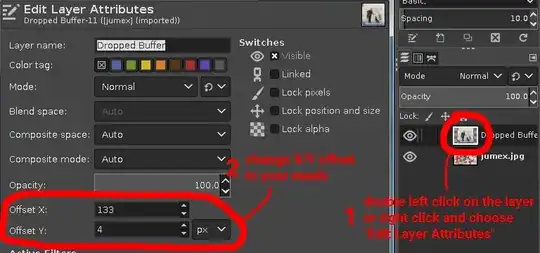

There's a very convenient way to do this available since the Gimp v.2.10:
  1. double click on the layer you want to move (or right click on it and select "Edit Layer Attributes")
  2. the "Edit Layer Attributes" dialog will show up and there you can change the X/Y offsets to your needs
Simply easy like that! :)
Edit Layer X/Y Offsets Attributes

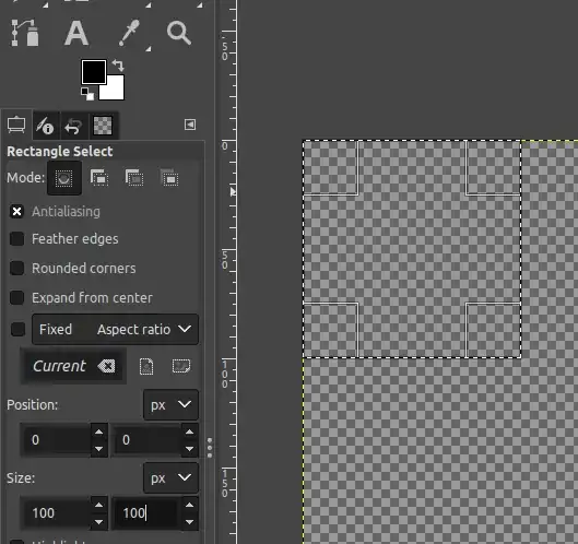

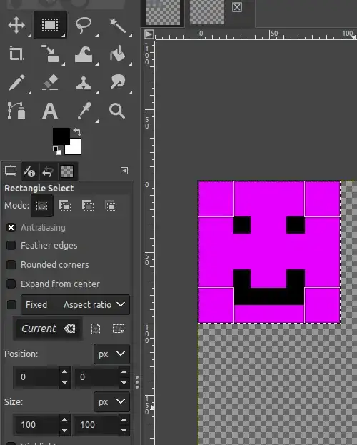

Here's a simple workaround to do it.
  1. Create a rectangle selection around your source area
  1. Click the selection so the resizing widgets disappear
  2. Ctrl+X to cut.
  3. Click the selection again so the resize widgets reappear
  1. Precisely choose a target position for the selection
  1. Click to hide resize widgets
  2. Ctrl+V to paste.
  3. Anchor or Apply to a new layer
