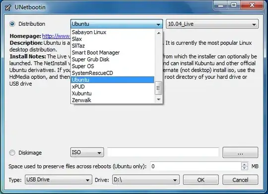

I am not sure if this works for Windows XP, but I have used UNetbootin in the past to boot a variety of floppy and Linux ISO images:
Goyuix
  • 6,511
  • 37
  • 48
  • I just tried this, having used unetbootin several times for Linux, but it did not work for a Windows 8 image. – Segfault May 27 '12 at 22:44
