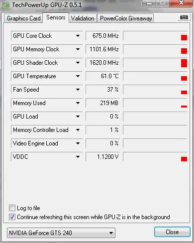

Note: As it stands it appears this is only valid for Nvidia cards, GPU-Z does not appear to be able to get this information on Ati cards.
You can see how much video memory is in use on any reasonably new Nvidia graphics card using GPU-z, which you can get from http://www.techpowerup.com/gpuz/
For example my card shows:
Note the "Memory Used" field. I believe this should be available on almost all current cards, though I don't have an Ati card to check.

  • No "Memory used" here.. Thanks anyways ;) – Simon Verbeke Jul 12 '11 at 18:25
  • That's a bit of a pity, I'd hoped a similar kind of information was available on Ati cards. I'll amend my answer to note that this currently only applies to Nvidia as it may be useful for the future if someone has a similar question, though for you specifically I will admit it is not much help. – Mokubai Jul 12 '11 at 18:36
  • It could be only my card is affected, or only the 4800 series. I'll look further myself too, thanks :) – Simon Verbeke Jul 12 '11 at 18:43
