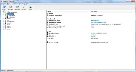

Accepting @Breakthrough's answer for HWiNFO32. Screenshot is actually conclusive (correcting my initial findings) - I have PCI Express 1.0 - it states that explicitly. This makes sense to me given that the motherboard is about 3 years+ old. Screenshot of HWiNFO32 showing the version of the PCI slot:

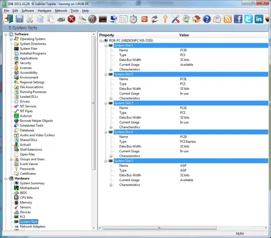

The other tool, System Information for Windows (SiW) that @KCotreau suggested stated the PCI Express bus characteristics i.e. voltage (3.3v in my case) and bus width (32bits in my case) but not explictly the bus version (as HWiNFO does) - i.e. whether or not it was 1.0 or 2.0 etc. But from those characteristics perhaps one could infer which version.

System Information for Windows generally looks useful and comprehensive - there are a lot of categories. See screenshot:
System Information for Windows (SiW) running
But HWiNFO32 explictly reports the bus version on the vacant slot (my original answer) so it is the accepted answer.

    If you're on Windows, you can try [HWiNFO](http://www.google.ca/url?sa=t&source=web&cd=1&ved=0CB8QFjAA&url=http%3A%2F%2Fwww.hwinfo.com%2F&rct=j&q=HWiNFO&ei=4VUkTsHGCc-2tgfogpGzAw&usg=AFQjCNHs_B7W1qCEOikVSc2zeEV8gg974g&cad=rja) (32/64)... Oh, and it's free :) – Breakthrough Jul 18 '11 at 15:49
  • If you'd supplied as an answer I would have +1'd you there which earns more reps than +1 on a comment i think. – therobyouknow Jul 18 '11 at 23:17
  • +1 @Breakthrough - this comment would be the accepted answer. I've created this on your behalf but if you write your comment as an answer I will move the 'tick'/'check' accepted answer to yours. – therobyouknow Dec 04 '11 at 10:50
Use "System Information for Windows":
http://www.gtopala.com/
One of the best tools I have ever used.

  • +1 Nice tool but I couldn't see anywhere in the tool screenshots that explicitly says PCI Express 2.0 or PCI Express 1.0. It does say PCI Express but no version number, one could assume the earlier version but who knows? – therobyouknow Jul 18 '11 at 23:18
    @Rob Did you run it or just look at screen shots? If you ran it, did you click on System slots? It clearly shows mine under "Data Bus Width". I also always save it as a web page. It makes it easier to navigate, imo. – KCotreau Jul 18 '11 at 23:25
  • +1 Yes, screenshots. I would have to pay (which is OK) before I can run the tool. There isn't a demo version, is there? Unless I'm mistaken. – therobyouknow Jul 19 '11 at 00:13
  • @Rob No Rob, it is free for personal use. If you are on a domain (corporate environment), it will bark at you, but you can still see the info if you look quickly. http://www.gtopala.com/siw-download.html (see bottom, freeware version). – KCotreau Jul 19 '11 at 00:17
@Breakthrough - your comment above would be the accepted answer. I've created this on your behalf but if you write your comment as an answer I will move the 'tick'/'check' accepted answer to yours and also +1 it :)

  • I'm trying with the latest version of HWiNFO and the line for 'PCI Express Version Supported' is not appearing for me. Do you have an old version where that line is reported by any chance? Or do you know how to find this information at present? – mickael Mar 06 '17 at 05:18

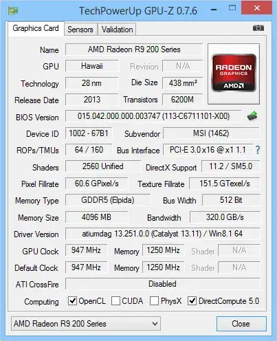

I would also suggest GPU-Z. The name and interface are very similar to CPU-Z, but it's optimized specifically for video card info. PCI Express version is shown in the "Bus Interface" box in the main tab.
GPU-Z screenshot
