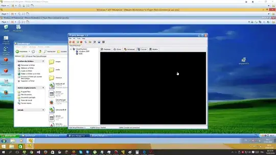

Yes, it is possible, given that your computer is powerful enough to handle it.
On my machine (i7 4770S, 16GB RAM) I managed to get a VM-ception-ness level of 4.5 (the last one crashes half of the time).
I used VMware Player 12, because VirtualBox didn't like emulating VM-x, and it was reaaaally slower. Right now, I'm trying to make W2K work on XP, but VMware can't install, VirtualBox produces BSODs so I'm trying using QEMU.
See this screenshot (one of the most beautiful screenshots I've ever seen):
zdimension
