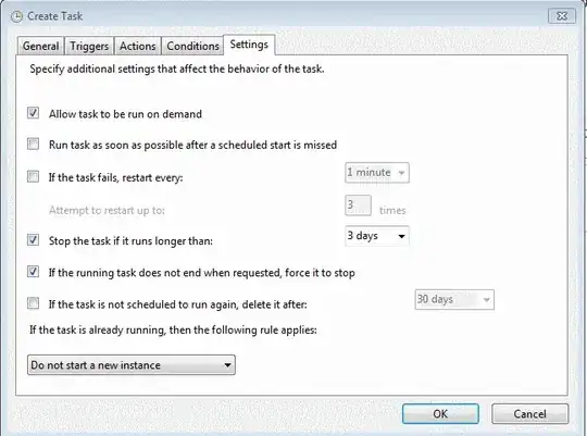

No, it won't execute. The Task Scheduler in Vista (or higher) can be configured to run missed instances, but XP's cannot. See the checkbox below called Run task as soon as possible after a scheduled start is missed.
However, all three can be set to wake the computer if it's asleep or hibernating.

    +1 You beat me to it, but I am going to add a screenshot. – KCotreau Jul 20 '11 at 00:19
    I'm using `schtasks` to set up the task (programmatically), do you know the flag for "Run task as soon as possible"? – Mark Elliot Jul 20 '11 at 00:21
    Just got here from a search on "windows 7 task scheduler missed task". Figured I should add a tidbit I found out in my search: the "Run task as soon as possible after scheduled start is missed" doesn't run the missed task immediately. There's a 10-minute delay. So if it was scheduled at midnight and the PC was off, it won't run until 10 minutes after you turn it back on. (Zombie comment, but might be useful.) – RobertB Apr 06 '14 at 23:31

As it was said, you can't do this in XP but can in Vista+. Some programs (like Acronis True Image) use their own schedulers to overcome the system one's limitations.
To emulate this in XP, you can write a program (googling didn't readily reveal any publicly available existing ones) scheduled to run at system startup that would
  • check the system log for the last shutdown and startup times (or rather, Scheduler service's shutdown and startup times)
  • check task schedules against that
  • run the ones who have a start moment that falls into the interval
Caveats:
  • unless you can somehow call the corresponding Scheduler's functionality, you'll have to parse the schedules manually to calculate the next planned start time from a specific moment in the past
  • there's no "run as soon as possible" flag for tasks in XP, you'll have to invent a replacement (or grab everything indiscriminately)
  • since your task runs at system startup, some tasks may fail if they require facilities that have not been initialized yet
