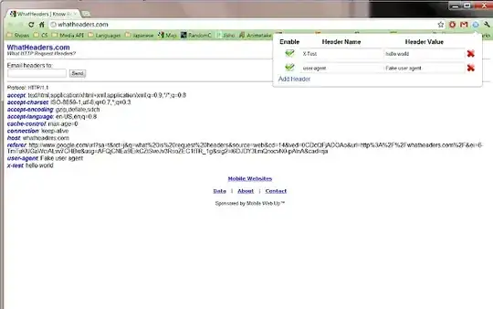

It is possible to modify the headers Chrome sends to a webserver using either userscripts (ala greasemonkey) or extensions. Here is one extension that should work: ModHeader
According to the introduction and screenshot, adding a header such as cache-control max-age=1000 should be relatively straightforward. It also supports domain whitelists to prevent headers from being sent to specific websites. You may need enable certain experiments in chrome://flags for this work.
demo of adding headers

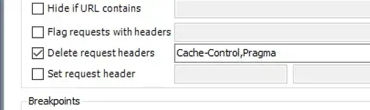

I'm trying to test caching on my website so need to simulate a 'new user', but of course Chrome sends Max-Age: 0 meaning the server's cache is bypassed so I can't test the server side caching.
What I found worked best for this use-case was in conjunction with Fiddler.
Chrome settings (must keep dev. console open)
and Fiddler:
This isn't good for the OP's issue - but I expect most people aren't currently finding this question due to the exact same problem.
Simon
  • 662
  • Why would you introduce a separate proxy, when you could use an extension in the browser to achieve the same end result? – womble Feb 05 '20 at 02:37
  • Because a lot of developers already have fiddler running and I like to minimize number of extensions running. It’s just another option. In my situation today I’m testing it then I’m done with it :) (I hope!) – Simon Feb 05 '20 at 02:53
