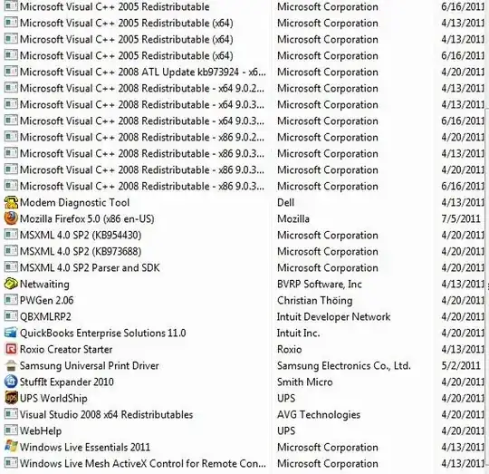

I'm trying to install Protector Suite on a users Dell Laptop and it is telling me I have a finger print reader already installed. I'm going to guess it is something that comes preinstalled but none of the programs say anything about Biometric or Fingerprint reading. Anyone have any ideas which software it can be?
My guesses: Intel Identity Protection, Dell Data Protection, Trend Micro CSA, Blackberry software, or Dell Drivers package
I don't want to just start uninstalling things, and when I've looked up each of my likely suspects they don't say anything about Biometrics.
Thoughts?

  • I upvoted and asked a friend to upvote you, so now you can post screenshots (edit your post, and click the image icon). Could you post them of your add/remove programs area? – KCotreau Jul 21 '11 at 15:48
  • I've added the pictures. I removed Dell Data Protection and when it was uninstalling it remove something I recognized as a finger print reader, but still didn't solve my problem. Any other ideas would be most helpful. – JohnSmith Jul 21 '11 at 16:35
I see nothing in the list.
I would download this tool, (even though no longer supported by Microsoft) and run it. You will see a list of installed programs: Find the one from UPEK (hopefully it will be there), highlight it, and click "Remove". Then try your install again.
http://majorgeeks.com/download.php?det=4459
http://en.wikipedia.org/wiki/Windows_Installer_CleanUp_Utility (good screenshot)

  • There was something from UPEK installed, I removed it using the Windows Installer Cleanup, but it is still failing to install. I restarted after removing it and tried again, still no success. – JohnSmith Jul 21 '11 at 17:46
