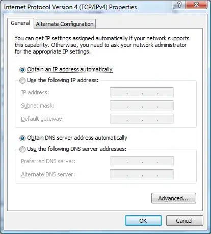

I believe the answer may depend on the version of Windows.
You can configure a list of DNS name-servers for each network connection shown in Control-Panel/Network-Connections.
DNS config dialog
You can see from the above that, for statically configured name-servers, one DNS name-server is considered the preferred one and the other an alternate. From this we can infer that the preferred name-server will normally be used for all queries, only if the primary is unavailable would the secondary be used.
We could assume that a list of DNS-servers provided dynamically (e.g. by a DHCP server) would be treated in a similar manner.
It is possible that the operating system might mark a name-server as down if it persistently fails to respond. Otherwise it must regard all of them as active - assuming the corresponding network interface is active ("up").
