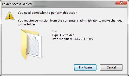

I have a really strange problem. I am using Windows 7 Professional with SP1 installed. I have a My Book 500GB external hard drive connected to the network via Linksys E3000. Now in Windows 7 I am logged in as Admin. The network disk is configured in Linksys, that an admin group can r&w. Now I have added this settings to Credential Manager, where I have specified network address of disk, username and password. I have added it, because otherwise the Windows 7 would forget the username & password on restart of the system.

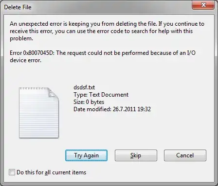

Now the network disk is working without problems. I can access file, write files on it, delete files from it. The problem arises, if I want to delete folder, that contains other files or folders. Now here for some reason it displays this error:
I tried Try Again, it displays Error 0x8007045D (I/O error):
This error is supposed to happen, when there is something wrong with USB port, or USB drivers, but this drive is not accessed via USB, it is a network based disk. Also, I don't have any problems with devices connected through USB, not that it matters in this problem.

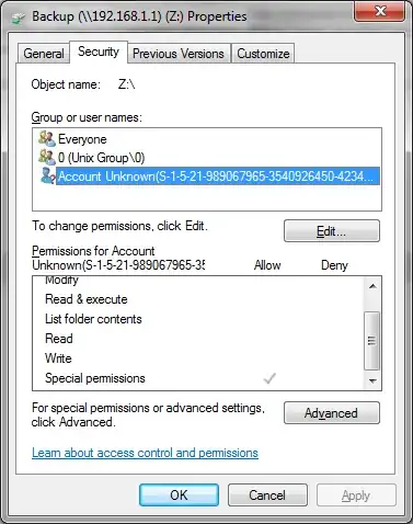

Then I clicked Cancel. Now what is really strange about this is, that the folder has gone missing! I will be able to see it again, if I reconnect the network disk, or restart the computer. Now I really don't understand about the permission thing, becuase I am already Admin. I have looked up under network disk properties -> security, and this is want I have found:

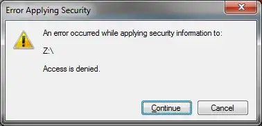

As you can see, it seems the account Account Unknown is what controls what can be accessed. It only has Special permission allowed. So I tried to change it to allow everything (which probably would not make a diffrence, because it seems that under that Special permission falls almost everything, as I said I can do everything except delete folders, that contain other files or other folders). When I wanted to apply the Full control that I have selected it gave this error:
It seems that I cannot change this permission. So I wanted to know who exactly is behind this permission, and I got this under Advanced -> Owner:
I guess the Linksys E3000 operates this permission. But as I have said in the first paragraph, I have setted the disk to adming group under Linksys E3000 setup (192.168.1.1), which means it has full r&w access.

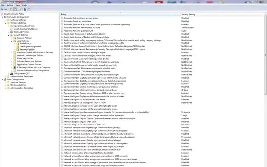

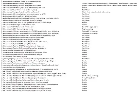

Edit: Adding screenshots of Local Group Policy Editor:
First part Second part

The fact that XP doesn't have these problems but Win7/Vista do is a dead giveaway. One of the biggest network changes in Vista/7 was the introduction of SMB v2.0. Along with that, they considerably beefed up the Windows Authentication process for the NTLM.
More than likely, the Samba server running in MyBook isn't up to date compatible with NTLMv2 and/or SMBv2. In general, Vista/7 will balk at older authentication methods that XP was ok with.

  • First of all thank you for your answer. Now I will go through your solutions. 1. solution: Had a problem finding the LAN Manager Authentication, so I went looking on the net, I found this:http://www.groupes.polymtl.ca/gchit/?page_id=238. I found out, that it was set to Not Defined. So I set it to Send LM & NTLM, as you said, but this did not solve the solution. I wonder if I should set it to Send LM & NTLM – use NTLMv2 session security if negotiated, as the tutorial on that link specifies? – Jernej Jerin Jul 26 '11 at 21:12
  • 2. solution: I have two Network Security: NTML SSP Session security defined, first one is: Network security: Minimum session security for NTLM SSP based (including secure RPC) clients and the second one is: Network security: Minimum session security for NTLM SSP based (including secure RPC) servers. Both have Require 128-bit encryption checked, but Require NTLMv2 session security unchecked. – Jernej Jerin Jul 26 '11 at 21:16
  • 3. Solution: I have set Network access: Allow anonymous SID/name translation to Enabled, was previously Disabled and Domain member: Digitally encrypt or sign secure channel data (always) is set default to Enabled. I do not recognize from your answer, do you want me to disable it? – Jernej Jerin Jul 26 '11 at 21:21
  • Ok I have also tried Send LM & NTLM – use NTLMv2 session security if negotiated, as was recommended in that tutorial two comments above. But with no success. @surfasb: Isn't that really strange, that it would not let me delete a folder in a folder? I mean I would be suprised, if it would not let me delete a file or a empty folder, but this is just plain silly. Please continue with your expertise, I would really like to get to the bottom of this. – Jernej Jerin Jul 26 '11 at 21:38
  • You actually want to lower the security, that's what I was going at. So for Lan Manager Authentication , set it to Send LM response only. You don't want to use NTLMv2 for toubleshooting. The `Domain Member :Digitally encrypt secure channel (always)`, set to disable. There should be a similar setting right below it, but it says `(if server agrees)` in parenthesis. Enable that one and make sure the `(always)` is disabled. Basically we are reproducing XP's network settings one by one. – surfasb Jul 26 '11 at 23:07
  • Sorry for late answer. I cannot set Network security: LAN Manager authentication level to Send LM response only, because it does not have that option. It only has the following options: 1. Send LM & NTLM responses, 2. Send LM & NTLM - use NTLMv2 session security if negotiated, 3. Send NTLM response only, 4. Send NTLMv2 response only, 5. Send NTLMv2 response only. Refuse LM, 6. Send NTLMv2 response only. Refuse LM & NTLM – Jernej Jerin Jul 27 '11 at 14:13
  • I have set Domain member: Digitally encrypt or sign secure channel data (always) to Disabled. The second one (if servers agrees) does not appear ot exis under Domain member. Maybe you mean this: Domain member: Digitally encrypt secure channel data (when possible)? I have this one enabled. – Jernej Jerin Jul 27 '11 at 14:17
  • I am adding a screenshot of my Local Group Policy settings to my first post. Please check it there, I think it will be easier if you can see all the current settings. – Jernej Jerin Jul 27 '11 at 14:21

Go to command prompt and type rd /s/q directory.

  • Interesting. Tried del, but that does not delete complete folder so I took a look on the Internet and found this command: rd /s/q folder_to_delete. Where rd stands for remove directory. The /s switch is for all sub directories and files in the dir. The /q switch is for quiet mode, which means it wont ask you for confirmation. And it delete files without any problem. If I don't find a solution for deleting folders with files in GUI Explorer, than I will be satisfied with this solution. Please update your answer with rd /s/q folder_to_delete, so that I will accept it if no other solution. – Jernej Jerin Jul 21 '12 at 11:43
It seems to me that you are using an account on XP that has no equivalent account on Windows 7, so Windows 7 calls it "Account unknown" and assigns it some arbitrary permissions on the disk. There have been large changes in account-management going on from XP to Windows 7, so making both share the same NTFS disk is not a trivial exercise.
In addition, the format of NTFS disks is not the same for XP and Windows 7. Windows 7 can understand the XP flavor, but XP might not fully understand NTFS formatted under Windows 7. So if you want to reformat the disk, do it preferably under XP. I would also guess that your My Book would also feel more comfortable with the XP version of NTFS.

  • The reason is probably that the phantom account didn't have the permission to delete a non-empty folder. The rd command worked recursively, always deleting the contents of the folder before deleting the folder itself, so it it didn't encounter the problem. – harrymc Jul 21 '12 at 13:16
