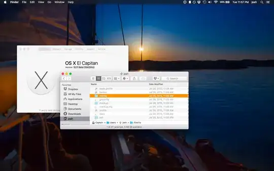

As of macOS Sierra Beta, .DS_Store is actually always hidden from the Finder. Just show hidden files as you would normally and .DS_Store will be gone:
defaults write com.apple.finder AppleShowAllFiles -bool YES && killall Finder

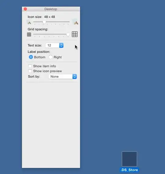

El Capitan user here.
I like to keep an clean desktop; no icons or links at all. I also need to see hidden files in Finder.
I "double clicked" the .DS_Store Icon and selected "Show View Options." In that window, I scaled the icon down to 16x16, and text size to 10. I set the Grid Size as small as possible as well.
I then dragged the icon down to the lower right, so I'm left with a tiny box in the lower right corner of the Desktop.
