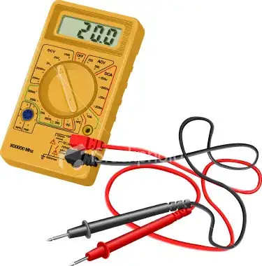

Use an ohmmeter or multimeter to determine if there is conductivity between the metal part of the wrist strap, and the end part where you connect it to ground. You should see some measurable resistance (indicating good conductivity) if the strap is functioning correctly. If the resistance is extremely high (or as some meters measure, infinite), then the strap is broken.
Alternatively, you can just use it as a "wire" in conjunction with something else (e.g. an LED) and determine if you can provide power through the anti-static wrist strap. If current can flow through it, it's working, since that is all the device is used for (to provide a quick path to ground for your skin).

    If the wrist strap has a current limiting safety resistor in line - which it should - the end-end resistance will be very **HIGH**, not low - perhaps 1-10M Ohms. – Linker3000 Jul 30 '11 at 18:26
  • @Linker3000 that is correct. Do note that if you're working on a computer system, you should use a wrist strap with a lower resistance in series with the strap (higher isn't always better when working with low voltage devices). – Breakthrough Jul 30 '11 at 18:29
