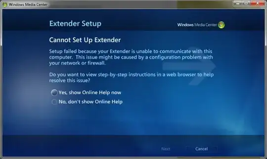

I have a Linksys E2500 router, an Xbox 360S, and a Toshiba Laptop with Windows 7. When I try to use the Xbox as a media extender for the laptop, it fails when I go through the router with the following error:
When I connect the laptop directly to the Xbox, they can find each other fine and I can stream video, but obviously this is not the solution, just a troubleshooting step.
