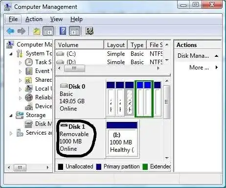

Here's a quick summary of the Windows link provided by harrymc, which I discovered independently:
  1. In Windows 7, open a cmd prompt with admin privileges.
  2. cd to C:\Program Files\Oracle\VirtualBox
  3. Run the following command:
    VBoxManage internalcommands createrawvmdk ^
      -filename "C:\usb.vmdk" -rawdisk \\.\PhysicalDrive#
    Replace the # with the disk number from disk management in computer management (Disk 1 in the image below).
    Disk number shown by Disk Management
  4. Finally, attach the newly-created vmdk within VirtualBox as an existing hard drive image.

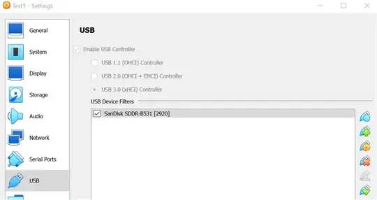

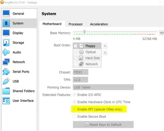

VirtualBox IS able to load from USB! However it is a bit tricky.
I was not able to boot from USB in BIOS mode, so enable the EFI mode!
Enable EFI
Now add the wanted USB device to the config to automatically mount it on start
Add USB to VM

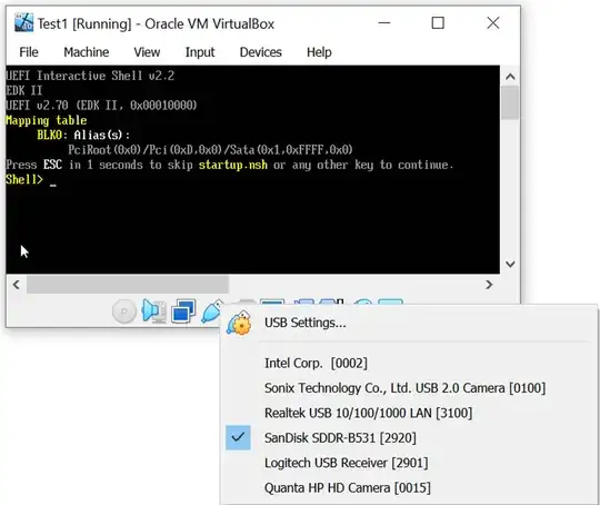

Now start machine
If the USB-drive is already detected, skip this step (the reset). However on some systems unfortunately right after start the USB-Stick might not be detected:
first boot attempt
make sure that USB is connected:
check USB is attached
If there is a general issue to mount an USB drive to a VM, see this post VirtualBox Error: USB device is busy with the previous request.

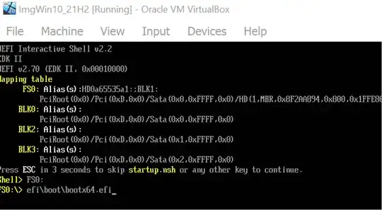

Now reset the machine (not power off) using the menu or hit Hostkey+R (ususally Hostkey is RightCTRL). You might be lucky and the system is already booting from USB. If not you need to provide the boot file manually. To do this you should now see an additional drive (here FS0: - no other drives are attached to my VM). If there is a vdi attached (this is always detected, probably as FS0:), you might find a new like FS1:
specify boot file
First type the 'drive' to boot from, here FS0:. Next you need to specify the efi-file, you can also use 'ls' or 'cd' commands to browse the folders on the USB drive. Provide file name (usually located below 'EFI') e.g. efi\boot\bootx64.efi. Hit Enter to boot from that EFI boot file.
It is possible to store this info permanently into the file startup.nsh, see here for a good explanation.

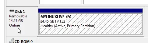

according to harrymc's source: you can not set up to boot from USB in the GUI, however, you can create a special virtual disk that only "redirects" to your physical usb pendrive, and attach that. here is the windows way (only, link contains it for linux too).
in windows host
  • attach your physical usb pendrive to your host computer
  • open/run diskmgmt.msc and check which disk number did windows choose for your physical pendrive:
example: example disk 1
  • then do this in cmd.exe:
cd c:\Program Files\Oracle\VirtualBox
-filename <path\to\usb.vmdk> ^
-rawdisk \\.\PhysicalDrive<n>
  • replace <path\to\usb.vmdk> to a path of your choosing, for the "redirect" disk file. example: e:\my_redirect_for_usb.vmdk
  • replace <n> in \\.\PhysicalDrive<n> with the number of your Physical drive, example: \\.\PhysicalDrive1 if your drive number is 1 (got from diskmgmt.msc above!)
  • aside: note, that ^ only means "line-continuation" in cmd - i did this only for better readability. You can write the whole thing in one line, instead -- just leave out any ^, then.
  • now you can attach the vmdk (example: e:\my_redirect_for_usb.vmdk) in Virtualbox like you do with any other hdd image
  • I managed to boot this way in 2014 :) ( -- the source article is from 2009)
