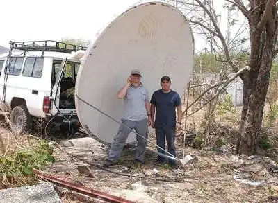

In a documentary on some SE Asian mudhole, motorcycle riders delivered email by having a wifi-equipped PC in the motorcycle trunk with a mobile whip wifi antenna and driving back and forth between urban and rural areas.
Computers along the route would recognize the availability of the signal to get off a few packets as the cyclist drives by. For short messages, this could be sufficient but big files require some waiting time.
At $10/hour ~ $1600/month, your company could enhance its internet service with a wireless N motorcyclist. For the cost of an extra used motorcycle he can switch cycles so that one is always exchanging data with the work site and one is always enroute.
Paul
  • 273
    Hehe... the "SE Asian mudhole" you are referring to is Cambodia. They did it here some years ago. – snap Aug 04 '11 at 14:28
  • Well, I don't recall the country, but the documentary featured lots of mud. I worked in Hong Kong for a while and never saw a dirt road. Even the hiking trails were paved, and some had nice brick staircases (e.g. east of Sai Kung). – Paul Aug 05 '11 at 03:38
  • Yeah, many muddy dirt trails here. Great fun to drive with a dirt bike! Not boring like sterile places such as Hong Kong and the west. :) – snap Aug 05 '11 at 04:21
