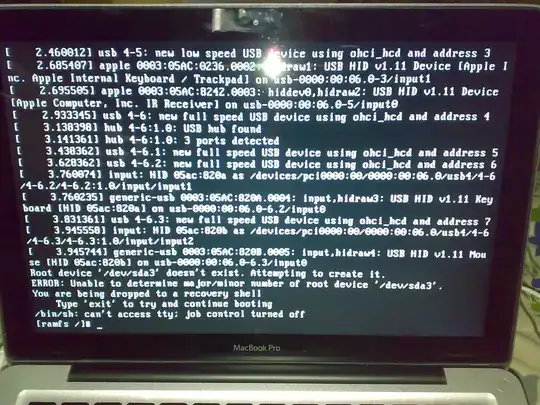

This is the exact error and then it drops to recovery:
Error after typing exit:
I have tried rootfstype too. No success.

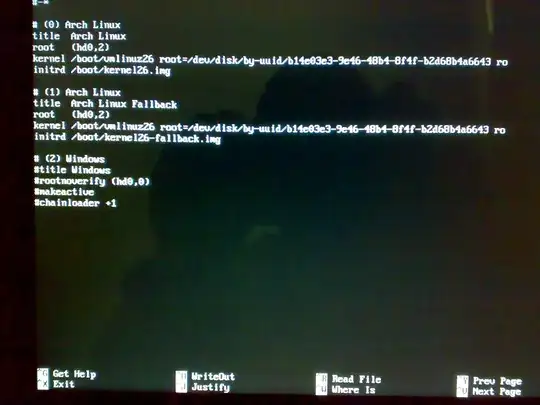

My menu.lst (I have tried /dev/sda3 too):

I think you have put a wrong entry in grub...put the correct entry for root section of the grub entry.You said arch is in 2nd partition right?? Then it should read like below
root (hd0,1)
Grub is not able find you disk partition containing Arch install;so drop you to a recovery shell.
The error msg also said that no /dev/sda3 partition exist!!! how did you install Arch??
