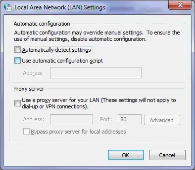

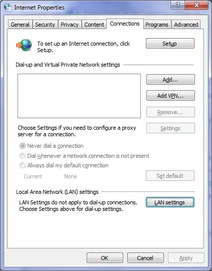

Assuming that you probably already have a Proxy Server in mind that you'd like to use, you can configure this for all applications in your OS through the Control Panel...
  1. Open "Control Panel"
  2. Double-click on the "Internet options" icon
  3. Activate the "Connections" tab
  4. Click on the "LAN settings" button below the "Local Area Network (LAN) settings" heading
  5. Enter your Proxy Server's address below the "Proxy server settings" heading

    Right , but what you just told is for only IE . but i want all my proggies to use SOCKS e.g Autodesk 3DSMax or whatever program should always use the SOCKS. – M3taSpl0it Aug 05 '11 at 15:24
  • Well, as I understand it most applications will use these settings as they are supposed to be OS-wide. Internet Explorer just defaults to whatever is specified for the OS (which is what these settings are for). Does this not work if you specify your Proxy Server here? – Randolf Richardson Aug 05 '11 at 15:27
    Not for me , check this with your `http://sockslist.net` . Everything will start to work if you type some web addresses in IE but not with FF or other applications. – M3taSpl0it Aug 05 '11 at 15:42
    Did you use the "Advanced" button to configure it specifically? After that, if you still have applications that won't use the Proxy Server settings you configured for them, you can always set up Squid (a popular free and open source Proxy Server) on another computer, which can be configured to use a Proxy Server of your choosing, and then use your Squid computer as your gateway. – Randolf Richardson Aug 05 '11 at 15:43
  • yes i had used the advanced tab. – M3taSpl0it Aug 05 '11 at 15:43
    If you can't find a "Proxy configuration" option in your applications (in this case, Autodesk 3DSMax), then it's probably bypassing the MS-Windows Proxy Server settings and you may need to go with the "Squid" option I suggested (or something similar). – Randolf Richardson Aug 05 '11 at 15:59
