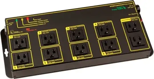

2) Get a remote-controlled power strip:
As echoback mentioned, there's products by DLI (Digital Loggers Inc.): Web Power Switch
I looked into this, and it was too expensive for small-time use. Perhaps the price has come down though. It was feature rich, but I've never actually used it.
