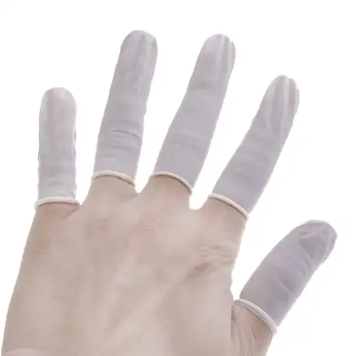

  4. Anti-Static Rubber Finger Stalls
    rubber fingers
Which of above mentioned actually do something?

As for product 4 (rubber finger covers), this would work, but only to a limited extent. The rubber provides a good insulator between your skin and the conductors, but if there was enough buildup of static electricity in your body, it could theoretically overcome this resistance. That being said, the resistance of rubber is extremely high, and I would recommend this product over 2 and 3.

  • How about discharging by touching chassis first and then wearing finger stalls to not accumulate any static buildup? And how about number 2? You think it does not have grounding? What if i constantly touch it while working with equipment in order to discharge static? – Boris_yo Aug 11 '11 at 14:52
  • You can discharge by touching the chassis first, but wearing finger stalls *does not* prevent you from accumulating any more static charge. Most of the charge comes from buildup from moving on carpets, or friction induction by other means... Lastly, the problem with 2 is the same as 3, there is just no path to ground. It doesn't matter if you touch it or not, there is no place for the buildup of static electricity to go. – Breakthrough Aug 11 '11 at 15:00

4 just looks dirty/funny! I have seen anti static gloves, but they can rip easily and can get in the way - especially when dealing with sharp edges / removing blanking plates etc.

  4. being antistatic probably means that they don't accumulate static electricity when used (rubbed), as rubber normally does. Probably they conduct somewhat, but this won't magically discharge your body, unless you also wear a wrist strap. The same applies to other things labeled ESD safe, for example plastic bags and tools.
