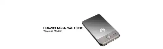

I recently upgraded from a HUAWEI E153 USB modem to a E583C mobile WiFi router.
The device grants my other devices Internet access through wifi perfectly, until I get located in my present office. Between five to thirty minutes, my dependent computers will lose wifi connection.
Attempting to reconnect will fail. Any new devices attempting to register its wifi network will also fail. It would take a really long time before it can "recover" and the wifi adapters can pick up the connection and regain Internet access. I am forced to plug in the USB cable to maintain a wired network connection instead.
My colleague has a similar mifi model, HUAWEI E5830, which she experiences the exact same problem - fine outside, guaranteed disconnection in the office.
First guess is there are too many other wifi access points in the building, so I tried switching around the transmission channels 1, 6, 11, and even 13 but none had better results. In expanding Windows network diagnostic logs it shows there are around 19 networks in the area, so I am guessing the interference is so great there is no way my little mifi device can compete. Even if I attach the extended antenna.
Below is the diagnostic log which I am unable to properly identify what I can do to further troubleshoot and possibly solve the problem in this office area?
