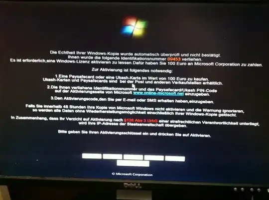

This thing popped up on the computer of one of my employees on Friday. I've spent most of the weekend scanning the computer with Avira AntiVir, Avira Boot Sector Repair Tool, Kaspersky Virus Removal Tool, Malwarebytes, Spybot, McAfee Stinger, and something else I forgot and all of them found something. Overall they all cleaned about 400 malicious items, except for this one.
This screen shows up right after the computer boots up and the user logs in. There's a slight lag while the OS is loading the profile and after that this pops up. I think it's something along the lines of a browser hack because I saw Firefox (3.6.18 I think) start up right before it appeared.
I can do CTRL+ALT+DEL and bring up Task Manager, but as soon as I do the virus screen overlays it.
What is this virus and how can I get rid of it?

It seems to be the BKA Trojan (the first couple of results are links to the scareware’s site, so don’t use those). It seems that the consensus is to either reinstall, or use more anti-malware software.

(Side note: I find it amusing that the trojan is using the Windows 7 logo even though the Alex has indicated that it is an XP system. sigh)

So, after spending several days fighting this thing, I finally got rid of it. I'm pretty sure I got the right one, but along the way I found some suspicious items that could have contributed. Here's the steps it took to clean it up.
First thing I did was to check all of the autostart locations on windows. I followed this article here. Most of the locations where clean except for:
  1. HKLM\Software\Microsoft\Windows NT\CurrentVersion\Winlogon\Userinit
    • This key had a second path on it pointing to C:\Documents and Settings\NetworkService\Application Data\09A52917-B4FC-4f02-AE3B-BF55D9351F4A\msvcs.exe
  2. HKLM\Software\Microsoft\Windows\CurrentVersion\Run
    • This node had a REG_SZ key named 2C508BD5-F9C6-4955-B93A-09B835EC3C64 which was pointing to the msvcs.exe file in the Userinit key.
  3. HKLM\Software\Microsoft\Windows NT\CurrentVersion\Winlogon\Notify
    • This node had two other nodes that looked suspicious to me. They were named \toldvw32 and torlfsvses. Both nodes had keys that pointed to a toldvw32.dll file and were set with a WlStartupEvent event. Looking these up on Google didn't produce any meaningful results at the time, so I went ahead an removed them. There doesn't seem to be problems with having done that yet.
The real issue is that msvcs.exe file. If one manages to survive it will replicate it self across all user profiles on the machine. Since it was hooked up into the NetworkService profile it would always make sure it existed in the other profiles.

This seems to be a brand new scareware. As far as I see, it has not been described by the antivirus specialists yet. It threatens to delete the contents of the disk and sue you for using an illegal copy of Windows.
