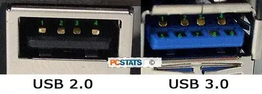

Pictures for USB 2 vs. USB 3 (USB 3 has 5 extra pins), Type A connector:
Female:
Male: (below is USB 3 with its 5 extra pins).
(image source)

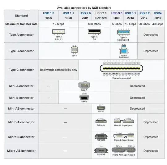

Wikipedia has nice schematics too, for different connector types:
