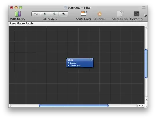

I uploaded this for you, you can download the screen saver file here.
If you want to do it manually, do it like this:
  • Open Quartz Composer.app. This is no longer ships with Xcode by default. You need to install Xcode first and then download the Graphics Tools for Xcode. Be sure to download the appropriate version. I copied the application files to /Applications/Xcode.app/Contents/Applications/ so they are listed under Xcode->Open Developer Tool.
  • Create a new blank file with the Screensaver template. Delete everything except for the "Clear" panel. You can also start with a totally empty window and drag "Clear" from the Patch Library to the work area.
  • Save it under /Users/your-user/Library/Screen Savers to make it available for you only, or /Library/Screen Savers to make it available for all other users. Doing the latter, you'll have to enter an admin password.
  • Then, select it in System Preferences under "Other".
And there you go, a simple black screensaver.

  • Thanks, that worked, but I had to save 'blank_screen.qtz' it to my home directory then 'sudo cp ~/blank_screen.qtz /Libraray/Screen\ Savers/blank_screen.qtz' .. could you update your post plz. – lexu Aug 27 '11 at 09:40
  • You only have to do this if you want to make it available system-wide (notice the difference between `~/Library`, which is in your home folder, and `/Library`, which is for all users. The former should work — but I'll adapt it to clarify. – slhck Aug 27 '11 at 09:45
  • @lexu Interestingly, this one showed "Quartz Composer" after a while. I fixed it and hope this now works perfectly. – slhck Aug 27 '11 at 13:19

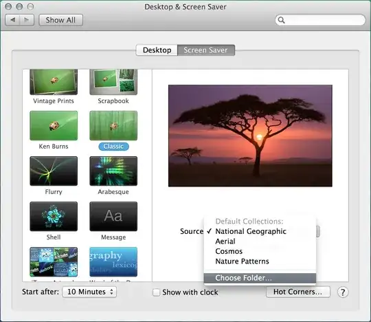

Simple is best for me.
Black Image
Place this flat black image in a folder and set that folder as your screensaver source for the Classic screensaver style.
Classic → Choose Folder

  • I did the same, and while this is indeed simple, I found that my system gets ridiculously hot while the screen is locked, with the fan spinning at max speed. – Stefan Majewsky Mar 09 '15 at 14:16
  • Odd - you might need to look into activity monitor or ssh into the Mac to see why the CPU/GPU is pegged. Or you could just turn off the screen entirely - why waste cycles drawing a black background? – bmike Mar 09 '15 at 14:52
  • When the screen is off, the load goes away. But I cannot control how long it takes for the monitor to turn off; my system settings are somewhat locked down by corporate policy. I've decided to go with the accepted answer and "programmed" a blank screensaver. – Stefan Majewsky Mar 10 '15 at 08:59
