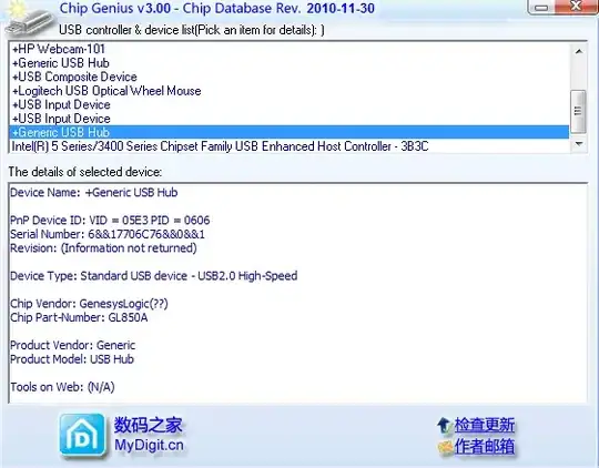

Try USBDeview to get the vendor ID, then look it up on a vendor list here or here
. enter image description here
Or use Device manager to find the vendor ID
There is also a utility called chip genius referred to on this page .

  • Vendor ID is 0403 (see my update to the question) but neither of the above tools is able to tell what product (by name) it is much less what chipset is used. – Piotr Dobrogost Aug 29 '11 at 17:52
