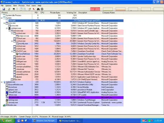

The problem still persists, here is the print screen of process explorer. enter image description here It's showing 96-100% cpu usage by interrupts. My machine is crawling because of this. Can anybody give me a solution?

  • That is very unusual, I would suspect a driver issue OR faulty H/W. You'll have to try a couple of things: (1) upgrade all your drivers, (2) remove all non-essential H/w, (3) uninstall drivers. If you do this one by one with a reboot it between you *may* find the culprit. – Itai Sep 06 '11 at 13:22
