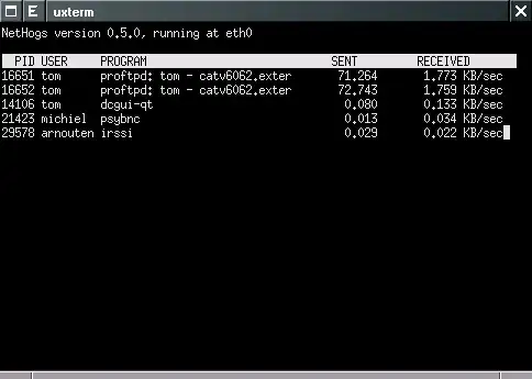

You can try NetHogs.
NetHogs is a small 'net top' tool. Instead of breaking the traffic down per protocol or per subnet, like most tools do, it groups bandwidth by process. NetHogs does not rely on a special kernel module to be loaded. If there's suddenly a lot of network traffic, you can fire up NetHogs and immediately see which PID is causing this. This makes it easy to indentify programs that have gone wild and are suddenly taking up your bandwidth.
NetHogs_Screenshot

  • Almost exactly what I need but it just doesn't work :( – vava Aug 31 '09 at 17:24
  • Well, what doesn't work? Any errors? Doesn't it start at all? Console output? – Milde Sep 01 '09 at 07:14
  • it not works with ipv6 – zb' May 29 '14 at 22:20
  • You have to run it as root. Promiscous mode is recommended. `sudo nethogs -p eth2`. You have to specify your ethernet if it is not eth0 by default. – Anandu M Das Mar 13 '15 at 05:39
  • @vava There's a problem with the one in the repo, it's fixed in 0.8.1 but you have to build from source (which is extremely easy). See this post: http://askubuntu.com/questions/726601/nethogs-%E2%86%92-creating-socket-failed-while-establishing-local-ip-are-you-root – Matthew Jul 10 '16 at 05:22
  • @AnanduMDas `man nethogs` says promiscious mode is "not recommended". – vossad01 Feb 07 '17 at 13:44
  • NetHogs v0.8.5-2 works fine when installing from apt-get. No need to compile from source – kurdtpage Jan 23 '18 at 20:20
  • How about that! It's my browser using the most data! Now I just have to find a Nethogs Chrome plug-in. (The Task Manger has a column for the current bandwidth, but not cumulative data use.) – Michael Scheper Mar 08 '19 at 02:13
