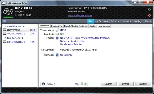

hddguardian works great with Intel Matrix RAID controller, essentially it's a GUI for smartctl.

  • This one's a winner for me. Argus Monitor was ok but hddguardian gives very understandable info about all the data and thresholds – nevster Jan 28 '15 at 10:20
  • Also works for my HDDs connected through the "LSI Adapter, SAS3 3008 Fury -StorPort". So, other RAID controllers might be suppported as well. – i3v May 10 '16 at 07:04
  • works for me as well. raid 0 ssd evo ty for software name – Furkan Gözükara Jun 27 '16 at 11:18
  • This looks great, but unfortunately the author received too many harassing complaints reported as "issues" and decided to shut the project down. – jimp Jun 05 '17 at 04:43
