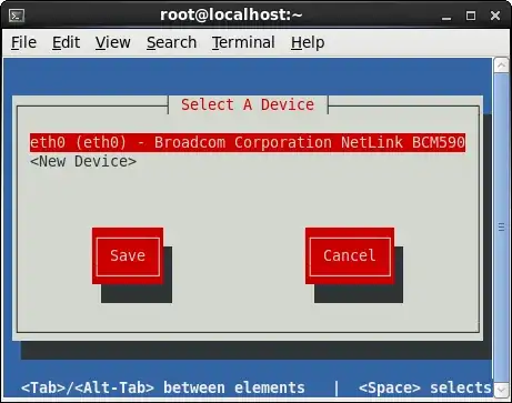

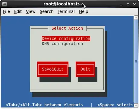

You can use this tool also (This is not a GUI tool, its TUI tool, Text-based User Interface)
[root@localhost ~]# system-config-network-tui
Type above command and press Enter
Then this screen will appear
Select Device configuration and press Enter
Here eth0 refers /etc/sysconfig/network-scripts/ifcfg-eth0
Whatever the edit made in eth0 that will affect to ifcfg-eth0 file
