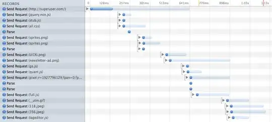

You can actually see this using Firebug or Chrome's debugger, when you enable timeline tracking. This is the timeline of loading Super User, filtered so that only requests are shown. Click to enlarge:
As we can see, the main Super User site would take the longest time to load, but cascading from it, there are other page loads (i.e. HTTP requests or cache requests) involved. All of those also expose their Content-Length, therefore the browser can make a good guess of how long it will take to load all these files.
And since all of this is happening within a very short time frame, you won't notice the small irregularities in the progress bar. Sometimes you will see the progress bar hang at two thirds – this might be when the browser fails to load an external resource as fast as the others.
