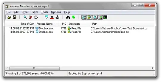

For any version of Windows, you can use SysInternals ProcMon. This gives a list of all current file, registry, and other actions. It can be filtered down to show just the data you want - in this case, what files Dropbox is accessing.
Open procmon.exe, and open the Filters dialog. Set the following filters:
Process Name   is           Dropbox.exe                     Include
Operation      is           ReadFile                        Include
Operation      is           WriteFile                       Include
Path           begins with  C:\users\YOURUSERNAME\AppData   Exclude
Path           is           C:                              Exclude
This will result in ProcMon only showing file reads and writes from Dropbox, excluding the config files that Dropbox accesses. Effectively, this will show you all files that Dropbox is uploading or downloading.
