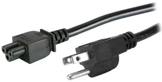

In addition to the capacitor and the battery level of the laptop, another factor that determines whether or not you see a spark is the actual plug itself.

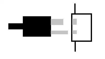

Most electric plugs these days are grounded, and in addition, the ground prong is a little longer than the other two (figure 1). This causes the ground conductor to connect first when you plug it in and disconnect last when you unplug (figure 2). This allows any excess current to dissipate to ground/earth.
On the one hand, this should prevent any arcing because the ground conductor should already be connected by the time that the other prongs connect, so it can easily dissipate any excess charge, but on the other hand, because the charge now has a place to go, and because the charge in such cases is large enough and the distance between the prongs is so small, having the ground connected and ready actually makes it possible for the charge to jump through the air and arc. If it were not connected, it would be at a dead-end and sit there waiting until the adapter is grounded, but that could potentially cause it to overheat or burn out, so it is better to leak the excess charge even if it makes a scary spark.

Figure 1: Photo of a grounded plug showing the slightly longer ground prong
Figure 2: Side-view of grounded photo showing the order of conductor connection
