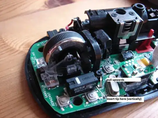

I had the same problem with the left button of my M705 and it turned out that it was indeed caused by a bad contact in one of the microswitches (an Omron D2FC-F-7N), which contained a copper part that was oxidized. I managed to fix this issue by opening the switch and removing the oxide from the contact pad, here's how to do it:
  • First, open the mouse. To do this, you need to remove the five screws that hold together the housing: Three of them are located under the black contact pads on which the mouse glides (the pads are just glued so you can remove them by pulling) and two are on the bottom of the battery compartment.
  • Open the housing of the defective microswitch by inserting the tip of a sharp knife or screwdriver into the slit between the black, upper part of the housing and the dark grey, lower part, first pushing the upper part slightly to the side and then upwards.
  • In the switch there is a small copper plate that connects to a contact pad on the lower part of the switch when the button is pressed down. Remove the plate by gently pulling it first to the side and then up. There is a small bump on the bottom right side of the plate that makes the contact with the lower part of the switch:
    Both the bump on the plate and its counterpart on the switch will probably be covered with a dark, bluish oxide that we want to remove: To do this, use a knife or a rasp to slightly roughen up the surface until it appears shiny and bright again. Then put all parts back into place and close the switch and the mouse.
  • Now the switch should again establish a reliable electric contact when pressed down, at least until it re-oxidizes...
Alternatively you could just replace the whole microswitch by a new one, which should cost less than a few dollars but is much less fun of course ;)
Also, before you jump into repairing your mouse check if it's still under warranty and if so consider having it replaced by Logitech, since opening it up will usually void its warranty.
This procedure should also be applicable to other mice that contain the same microswitch, most notably to Logitech G series, Apple's 3G, 4G, 5G series, some Razer mice and Microsoft's Intellimouse Optical.

    And after 3 hours I have officially completed the procedure! Thanks a ton for pictures - couldn't have done it without them. For anybody who wants to embark on same journey - getting plates back is the hardest part - make sure you look at the image as to how they should be positioned. And that curvy thingy on plate needs to be pressed against the "wall", like on this image: http://media.photobucket.com/image/microswitch%20plate%20mouse/SolidxSnake13224/IMG_8884.jpg Thanks again @ThePhysicist!! – nikib3ro May 11 '12 at 12:50
  • And if anybody has recommendation on most resilient/durable mouse (uses something other than micro switches?) - please feel free to give your suggestion. I like/use Logitech mouses not because I believe they are best, but simply because they have best warranty; however I would prefer to have a mouse that won't mess up after year-two. – nikib3ro May 11 '12 at 12:55
    To easily reassemble the copper plate first secure (e.g. with tweezers holding the plate) both ends while having the middle "U" shape above where it should be. Then _gently_ press down the middle "U" with a pin/second pair of tweezers. – Peter Uhnak Dec 17 '15 at 18:47
